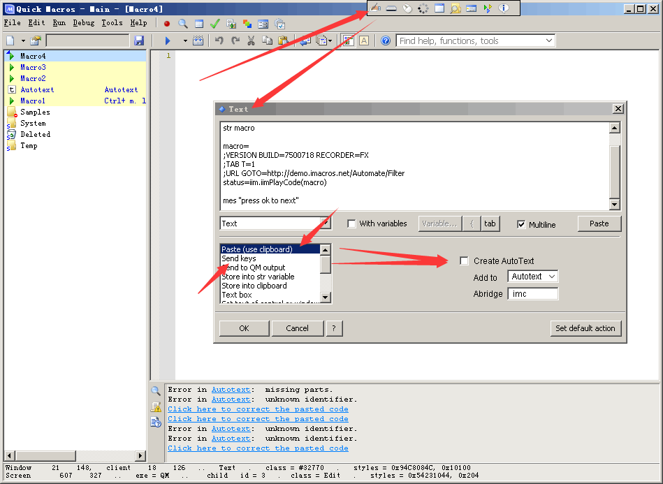

Recommendation: I can create an AutoText directly from the (text dialog) (for example, the following image)
Select the Create AutoText check box to create a new AutoText file
The Add to drop-down box can be added to the specified AutoText file
(Abridge box) In the box here, I can define acronyms

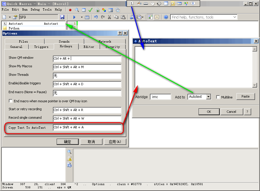

It is recommended to add the AutoText button on the floating toolbar, so that the operation will be more simple, the following picture
Posts: 276
Threads: 34
Joined: Dec 2016
It is recommended to add a global hotkey to the AutoText, and I can create the selected text as AutoText directly! The picture below !
Select the text, press ctrl + shift + Alt + A hotkey will copy the selected text to the AutoText window, and then you can directly set the relevant options, this will be very convenient
Posts: 276
Threads: 34
Joined: Dec 2016
AutoText, is a very useful feature, add the above global hotkey and set window, will be very intuitive, simple, easier to use

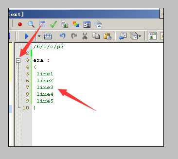

Posts: 276
Threads: 34
Joined: Dec 2016
Recommendation: Multi-line AutoText, like the following picture so, it looks very simple, clear, if the show in a row, not easy to maintain and manage
If a multi-line AutoText is defined as a subroutine, do not understand the programming people, understand some difficulties
Posts: 276
Threads: 34
Joined: Dec 2016
Suggest:
Add a global hotkey (Ctrl + Alt + Shift + A) and a AutoText button (floating toolbar), see the following image
This dialog box can greatly facilitate the creation of AutoText, At any time, see good code, you can press a hot key: Ctrl+Alt+Shift+A to define your own AutoText
I think the use of QM can add such a function, but my programming level is not good, not the ability to achieve this function, I hope the developer can help me,
I think that this is also a good learning programming case that helps improve the level of programming,
Thank you very much
