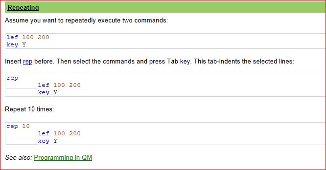

monitor blank area of window for any change
you changed the code sample i provided
when you use a rep in qm code all lines that you want to repeat must be tabbed
see picture
even if you had the code tabbed after the rep line all it would do would just click the buttons
 code should look like this
if you want it to keep scanning for a change then click buttons
RECT r
SetRect &r 2000 710 2500 900
int w=win("WSJT-X   v2.0.0   by K1JT" "Qt5QWindowIcon")
,wait 0 -S "" w r 16
,#region Recorded 1/21/19 10:43:15 AM
,lef 2926 1056 w 1 ;;push button 'Halt Tx Alt+H'
,lef 3652 1388 w 1 ;;radio button
,lef 1748 1060 w 1 ;;push button 'Erase Alt+E'
,lef 2456 1062 w 1 ;;check box 'Enable Tx Alt+n'
,#endregion
,1
