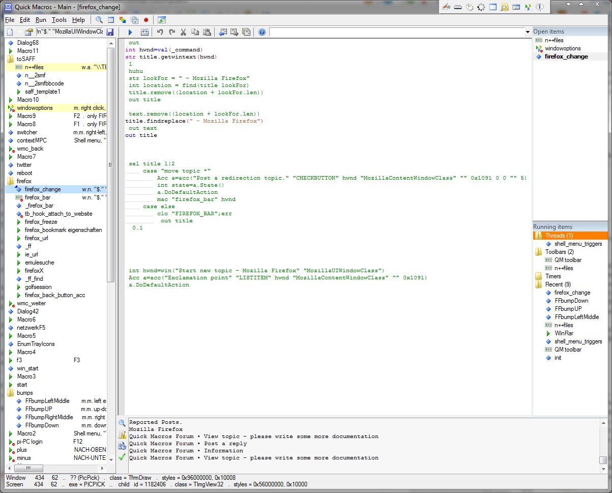

please write some more documentation
what about some tutorials here in the forum about how to work with the qm editor?
it would be nice to see your way of using qm.
pi
I don't have some special way or system of using qm. 90% of time I use qm to develop and test qm itself. 10% - write macros on demand. Don't know what tutorial I could write. I think everything is documented or self explanatory. Please give a list of things that are not clear.

i mean working with the qm editor when coding.
pi
forgive me pi, didn't realize it was you....I think you used to have the name pi in the Author column of your posts. Of course you already know the things I posted. I thought it was someone going through my early experience and just wanted to share friendly advice. I understand now that you mean specifically how to use the QM editor itself to make the act of coding more efficient. I do use favorites, and the "mirror in right", "shift to right" functions of active windows ALOT since the update that brought them to QM. Like you, I think I could still get a lot more out of it if I understood more. Thanks for putting your query up to the forum.
