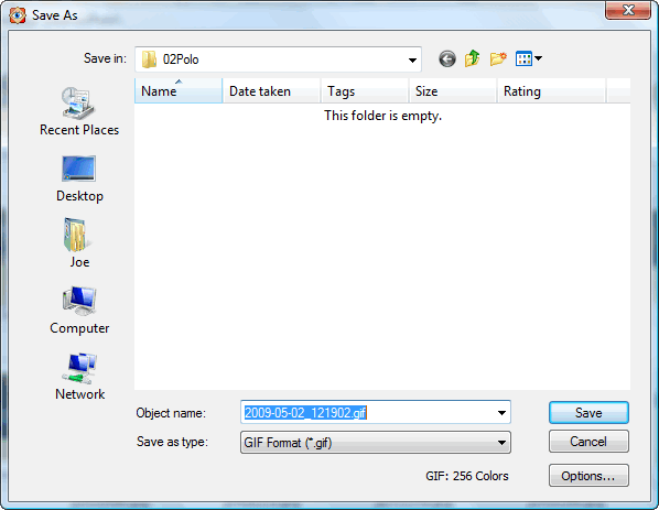

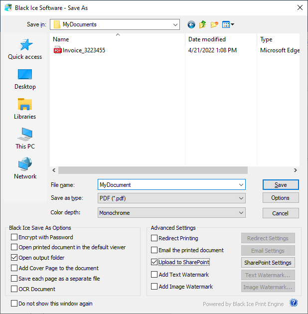

Is it possible to get the path of a file from any dialogbox that has 'save as' in its window title name above (top left).
Example
other example, if image above isn't displayed:
http://www.blackice.com/images/SaveAsDialog.png
In these examples the dropdownlistbox in the top of the 'save as' dialogbox shows a tree based folder structure where I can't 'get' the path.
