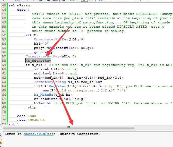

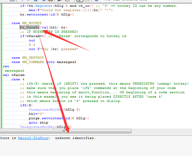

Hello, I am watching a video tutorial 18
I run the following code, the prompt is undefined, can you guide me, where can I find this custom function? Thanks in advance
I have encountered this problem in other tutorial code files. If export the related files to a .qml file, it will be more convenient to use.
code File : 13 (2).txt

Thank you for pointing that out.
Create function "hk_MakeHr"
And put the below code in it
Function hk_MakeHr
function int'hk str&hr
;Retrieves the human-readable format of an virtual keycode which is in integer format
;hk - hotkey in string format, example: "577"
;hr - the human readable format will be put in this variable
int k_vk
int k_mod
str human_readable
k_vk=hk&255
k_mod=hk>>8
FormatKeyString k_vk k_mod &human_readable
hr=human_readable
human_readable=""
Thanks for your reply, still prompted the following error
Also, the video 20 code file: 2 also prompts the following error
In addition, I found that many code files have lost custom functions. I hope to retest all the code files on a newly installed QM software. The code in the video tutorial is very valuable. Thank you again for your greatness. work
Create function "HkSetHotkey" and paste all the below code in it:

If possible, I suggestion to use QM to export all code files. In the first line of the code file, it is the link address of the youtube video tutorial, this will be more convenient to use and maintain, Idea please see the image below
The file name of the above function is wrong, please change HK_SetHotkeyDlg to hk_Sethotkey
If I find the time I will go through the source code and re-check them and find a better solution to keep them manageable. Thank you for the double check.
