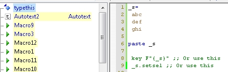

I do not know if the following is of any use, but I will mention it any way.
With "Autotext" (Above in menu, File >> New >> New Autotext List) Autotext lists are used to execute commands when you type certain text.
Whenever you type @typethis@, the text defined within _s in function "typethis" is placed.

If you need to do a lot of actions or something complex then do it in a seperate function (like the "typethis" example).

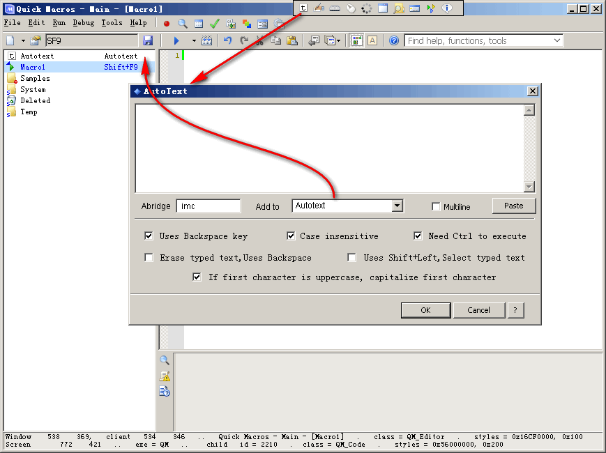

Recommendation: I can create an AutoText directly from the (text dialog) (for example, the following image)
Select the Create AutoText check box to create a new AutoText file
The Add to drop-down box can be added to the specified AutoText file
(Abridge box) In the box here, I can define acronyms

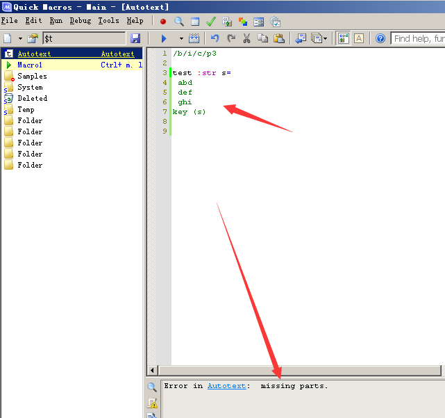

Finally succeeded, but if more AutoText, the code is not easy to read, not easy to maintain
Hope that in the future version, the code below, it can run successfully
/b/i/c/p3
imc
tr s=
;IDispatch iim._create("iMacros")
;int status=iim.iimOpen("")
;str macro
;macro=
;;VERSION BUILD=7500718 RECORDER=FX
;;TAB T=1
;;URL GOTO=http://demo.imacros.net/Automate/Filter
;status=iim.iimPlayCode(macro)
;mes "press ok to next"
;macro=
;;TAG POS=1 TYPE=INPUT:TEXT FORM=NAME:form1 ATTR=NAME:textfield CONTENT="Image Filter"
paste s ;; or key (s)

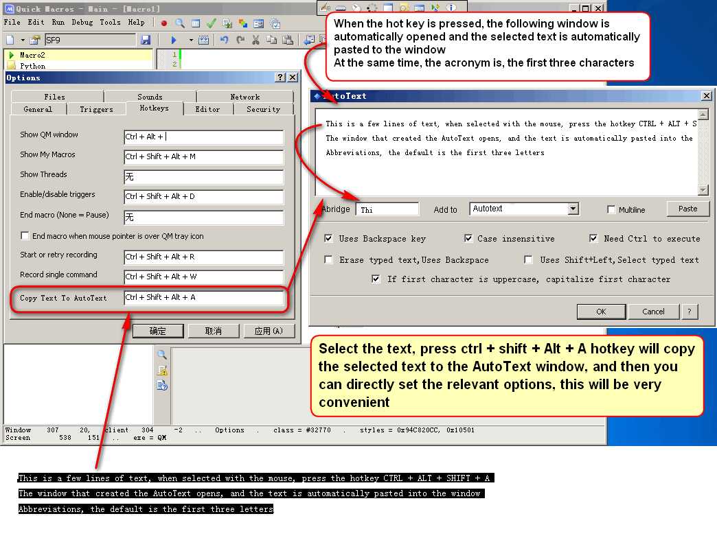

It is recommended to add a global hotkey to the AutoText, and I can create the selected text as AutoText directly! The picture below !
Select the text, press ctrl + shift + Alt + A hotkey will copy the selected text to the AutoText window, and then you can directly set the relevant options, this will be very convenient
Posts: 276
Threads: 34
Joined: Dec 2016
AutoText, is a very useful feature, add the above global hotkey and set window, will be very intuitive, simple, easier to use

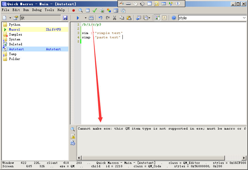

I would like to AutoText, generate exe file, shared with my friends to use, but when the generated error
QM does not support AutoText to generate exe files? If it can be generated on the great, AHK can be achieved
Posts: 11,922
Threads: 138
Autotext in Quick Macros 2 is not supported in exe.
Posts: 276
Threads: 34
Joined: Dec 2016
I look forward to the future version can support the generation exe file, because can generate exe, AutoText will be very useful,

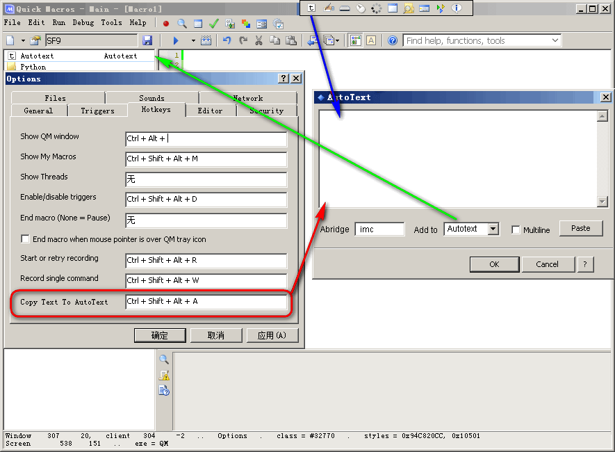

Recommendation: Multi-line AutoText, like the following picture so, it looks very simple, clear, if the show in a row, not easy to maintain and manage
If a multi-line AutoText is defined as a subroutine, do not understand the programming people, understand some difficulties
Posts: 276
Threads: 34
Joined: Dec 2016

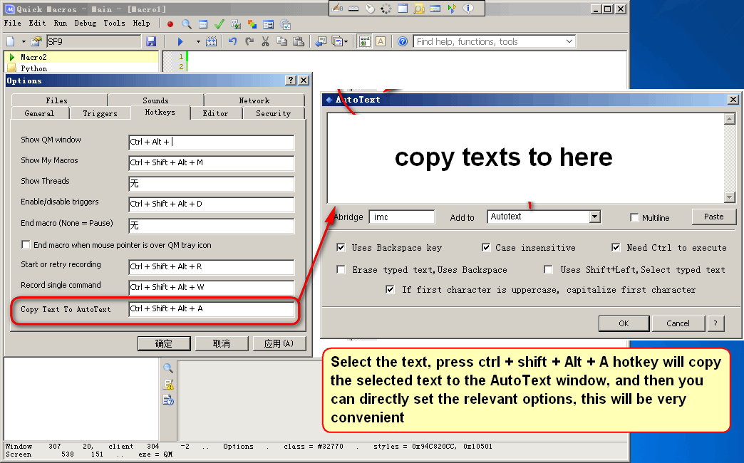

Suggest:
Add a global hotkey (Ctrl + Alt + Shift + A) and a AutoText button (floating toolbar), see the following image
This dialog box can greatly facilitate the creation of AutoText, At any time, see good code, you can press a hot key: Ctrl+Alt+Shift+A to define your own AutoText
I think the use of QM can add such a function, but my programming level is not good, not the ability to achieve this function, I hope the developer can help me,
I think that this is also a good learning programming case that helps improve the level of programming,
Thank you very much
Forum programming master, can try it , too 8)
