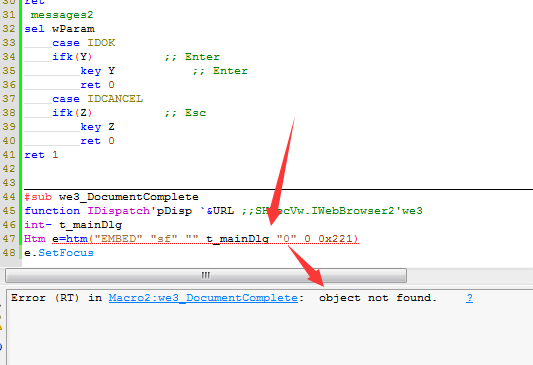

Htm e=htm("EMBED" "sf" "" t_mainDlg "0" 0 0x221)
e.SetFocus
An error occurred Huh
restart qm and try again
Still no object found

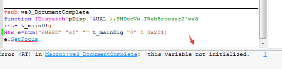

Htm e=htm("EMBED" "sf" "" t_mainDlg "0" 0 0x201)
if doesnt work you will need to create your own htm statement.
floating toolbar
After changing to 201
pointing to which variable?
try restart qm again

Error (RT) in <open ":1: /977">Macro2:we3_DocumentComplete:  this variable not initialized.    <help #IDP_ERR>?

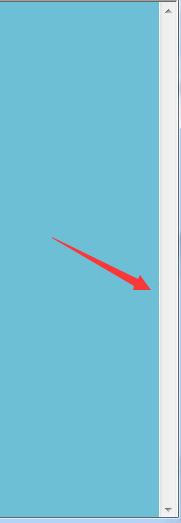

How to hide the right scroll bar? I did not find the style options
Oh i see your loading different  file. No wonder it doesn't work. The flash or html page which ever it is bigger than the dialog control that's why the scroll bar.
on my pc there is no scroll bar .It auto sizes to fit dialog control on my pc. must be a win7 issue or browser control is running in compatibility mode again.
