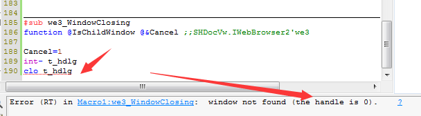

I just found a problem. If the page is opened in the modal window, after using the above code, the main window and the modal window will be closed at the same time. Then the error in the image below will appear. I just want to close the modal window. I need to modify it. Where? Undecided  thanks
@Gintaras
This is my complete code. When the webpage is opened from a subwindow, it will close both the main window and the modal window
In addition, I have defined four hotkeys, two in the main window and two in the child window. I often have hot-key errors. Because I have limited programming, please give me more instructions. Thank you.

the error message is very clear your variable has no value  so therefore  will error every time because your saying clo 0
the reason is because your missing a declaration that assigns a value to that variable.
i'm guessing you removed that part from further up in the code
In its current state it's just an empty variable.
 read more here
http://www.quickmacros.com/help/Language...ABLES.html
and here
http://www.quickmacros.com/help/Language/IDP_SCOPE.html
 read section
Variables, constants, numbers, strings

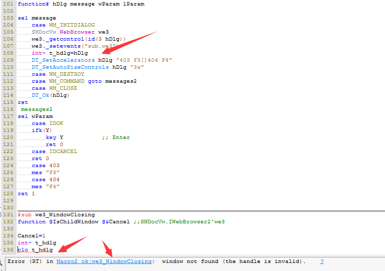

Quote:In addition, I have defined four hotkeys, two in the main window and two in the child window. I often have hot-key errors.
__RegisterHotKey registers hotkeys that work in all windows of all apps, and fails if that hotkey is already registered by some app or some your dialog. Why not to use DT_SetAccelerators? http://www.quickmacros.com/forum/showthr...2#pid31122.
I modified the code to use DT_SetAccelerators instead of __RegisterHotKey, but F1 and F3 do not take effect. F2 clicks the OK button in the main window to close the main window. why? Huh

Take a little more time  to understand how the function  works id 1 and 2 are for ok and cancel buttons which you  don't have in your  dialog
dialog ids 0,1, and 2 are reserved
id 1= ok button
id2= cancel button
if you would be more specific as to what you want these Accelerators keys to do we can help more

The following error, I have been trying to find a solution, but the ability is limited, can not be resolved, I search a lot of code about the modal window in Google, can understand the meaning, but can not solve the problem in QM, No similar case was found on the QM forum.   can you help me again?  Smile
Error (RT) in <open ":3040: /2759">Macro2 ok:we3_WindowClosing:  window not found (the handle is 0).    <help #IDP_ERR>?
Macro [b]Macro2 ok
[/b]
#sub we3_WindowClosing
function @IsChildWindow @&Cancel ;;SHDocVw.IWebBrowser2'we3
Cancel=1
int- t_hdlg
clo t_hdlg

Again the error is because  the variable  has no value
Its  saying  close nothing  which qm or any program would red flag and say no i can't do that with clo function
Please take more time to read qm help it will better explain how things work
a variable needs specific things in order for it to do anything for example
you cant just say
i=4
or
url="www.google.com"
and then use it
first have to declare it
int i=4
str url="www.google.com"
and also need to understand what  the declarations mean
int is for numbers but only certain types of numbers
str can be many things
read again
help topics
in category Variables, constants, numbers, strings
this information is also built into QM itself under help
since your trying to close the child dialog need to first set the child dialogs window handle value to a variable in his case variable t_hdlg and pass that id to the child dialogs close sub function to the close the child window

It's a little weird , in actual use, many times, the main window and sub-window will still close at the same time   Huh
The following prompt appears:
window not found (the handle is invalid).    <help #IDP_ERR>?
The first time I click on the link, the popup window closes automatically and it's normal.
The second time I click the link, the main window and child window will be closed at the same time Huh

Didnt have that  issue here. Maybe better to not use child dialog since  your  not passing anything back to main dialog.there  are other options .cant tell for sure from  error  message  what is rhe issue  maindialog will close  if error  anywhere in the  function code including  sub  function ect. The error mesaage has a click able link  click it  it will show the  line that the error  came from
On my windows 7 system, I can run it successfully only once. The second time ,All dialogs close at the same time
I can confirm i am having the same problem. and same error 2nd time clicking link dialog2 handle is 0

change code  to
Cancel=1
int w=win("Dialog2" "#32770")
clo w
Thank you very much. It is working fine now.   Heart

after some more testing this is probably a better solution
just need to move the 1st t_hdlg declaration statement out of WM_INITDIALOG

int hDlg2=sub.Dialog2
SHDocVw.WebBrowser d2_we3._getcontrol(id(3 hDlg2))
ppDisp=d2_we3
#sub Dialog2
function# [hwndOwner]
;0 "" 0x90CF0AC8 0x0 0 0 900 432 "Dialog2"
;3 ActiveX 0x54030000 0x0 0 0 900 432 "SHDocVw.WebBrowser {8856F961-340A-11D0-A96B-00C04FD705A2}"
;DIALOG EDITOR: "" 0x2040700 "*" "" "" ""
str controls = "3"
str ax3SHD
ret ShowDialog(dd &sub.DlgProc2 &controls hwndOwner 1) ;;modeless dialog
#sub DlgProc2
int- t_hdlg
,SHDocVw.WebBrowser we3
,we3._getcontrol(id(3 hDlg))
,we3._setevents("sub.we3")
,t_hdlg=hDlg
,DT_SetAccelerators hDlg "403 F3[]404 F4"
,DT_SetAutoSizeControls hDlg "3s"
,case WM_CLOSE
,DT_Ok(hDlg)
,ifk(Y)
,,key Y           ;; Enter
,,ret 0
,ret 0
,case 403
,mes "F3"
,case 404
,mes "F4"
Cancel=1
int- t_hdlg
clo t_hdlg
WM_INITDIALOG is called many times when creating a dialog so for some reason t_hdlg=hDlg was losing its value.
but either solution will work
both variables are of the same type just different scope is different. w is a local variable t_hdlg is thread variable
read more here
