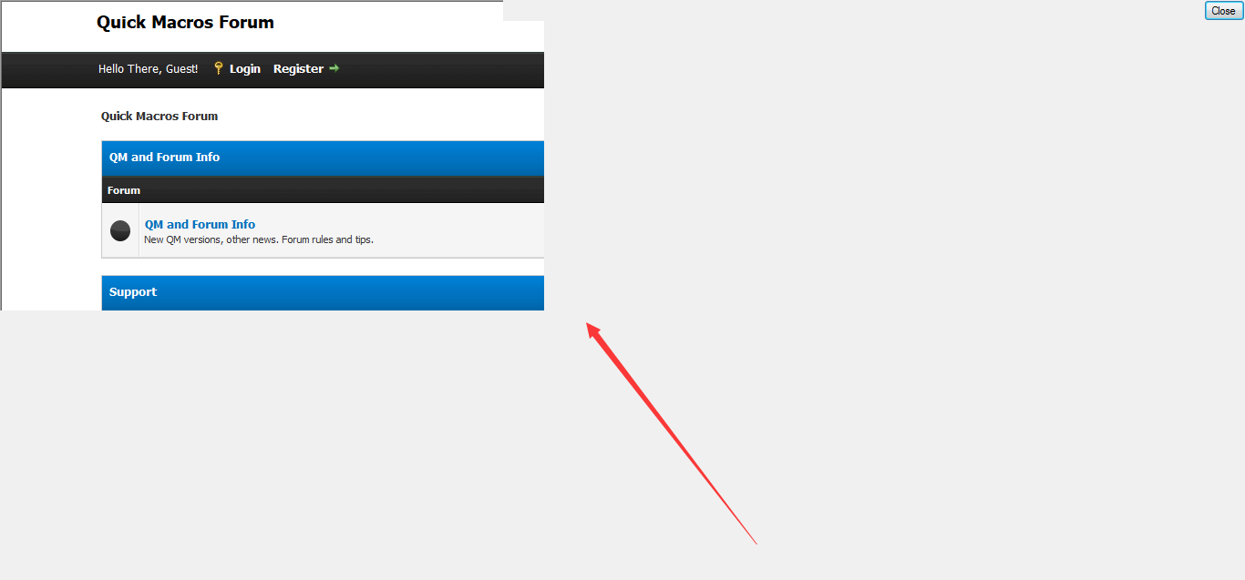

I want to right-click on the button to maximize the window, how to add code?   A button for closing, dragging, and maximizing functions  Wink
you have done this before only difference is using right click just need to add case statement in

,case [WM_RBUTTONDOWN,WM_RBUTTONUP]
,int- Fullscreen dialoghandle
,if Fullscreen =0
,,max dialoghandle
,,Fullscreen=1
,,res dialoghandle
,,Fullscreen=0

Great, very much admired your programming skills, almost everything  Smile
I have encountered a problem in use, web pages can not be refreshed in time  Huh

not having that issue add
WebBrowserControlDisableIE7Emulation
 and see if it corrects the issue
http://www.quickmacros.com/forum/showthr...p?tid=6458
