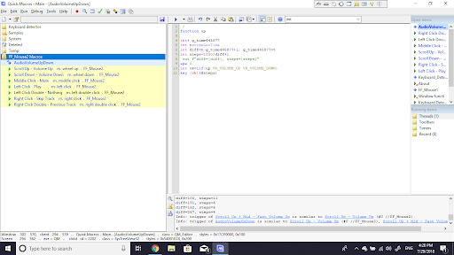

Here's what I have so far, if this helps.
EDIT: Inserted it as an image here, but was super small. It's attached now.
Don't add trigger to AudioVolumeUpDown. Add to these 2 macros that have wheel triggers. I see in the image, already added.
