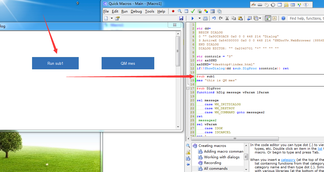

execute QM commands from buttons on a web page
Web design software can be very convenient layout. Can I execute QM macro commands on the buttons of web pages?
I hope the developer can provide some sample code, thanks in advance.
;0 "" 0x90C80AC8 0x0 0 0 448 214 "Dialog"
;3 ActiveX 0x54030000 0x0 0 0 448 214 "SHDocVw.WebBrowser {8856F961-340A-11D0-A96B-00C04FD705A2}"
;DIALOG EDITOR: "" 0x2040701 "*" "" "" ""
str controls = "3"
str ax3SHD
ax3SHD="$desktop$\index.html"
#sub sub1
mes "this is QM mes"
.zip   index.zip (Size: 882 bytes / Downloads: 504)
download this file for an example
http://www.quickmacros.com/forum/attachment.php?aid=132
it uses older way of setting browser events but it will show you how the process works

function MSHTML.DispHTMLInputElement'btn3
;on button3 click get html document
MSHTML.HTMLDocument doc=btn3.document
,;get select box element and selected item
int- t_hdlg
Htm e=htm("SELECT" "programlist" "" t_hdlg "0" 0 0x101 3)
str selItemText result1 result2
int selItem=e.CbItem(selItemText);;finds the selected item
result2=e.el.getAttribute("value" 0);; stores program name to run
result1.from("Next Will Open " selItemText);; makes a string for mes
mes result1;;; show run message
run result2;;; run selected program
#sub button4_onclick
function MSHTML.DispHTMLInputElement'btn4
;get document
MSHTML.HTMLDocument doc=btn4.document
;;get text from input
MSHTML.HTMLInputElement text=+doc.getElementById("message1")
str s1=text.getAttribute("value" 0)
if(s1.len)
,mes s1;; show text in a message
,mes "Opps!! You didnt type a message"
here is the revised html file to go with this
.zip   index+revised.zip (Size: 1.03 KB / Downloads: 448)
works for me but again i will try and stress this is not a good idea.
Well, I also feel that there is a real risk of running.
there are  few problems with the text area idea
1. typos if you make typo it will fail and close dialog
2. if qm command is type wrong will fail and close dialog
3. handling unknown data is not easy to many variables to try and contend with
check out my posted solution  its very user friendly and eliminates errors.
if you give us a better idea of your ideas on what you would like to implement in this form can help further
