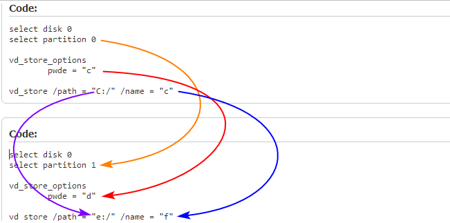

Example:
The following command is in the abc.psl file, I want to change it to the bottom code.
select disk 0
select partition 0
vd_store_options
    pwde = "c"
vd_store /path = "C:/" /name = "c"
select disk 0
select partition 1
vd_store_options
    pwde = "d"
vd_store /path = "e:/" /name = "f"

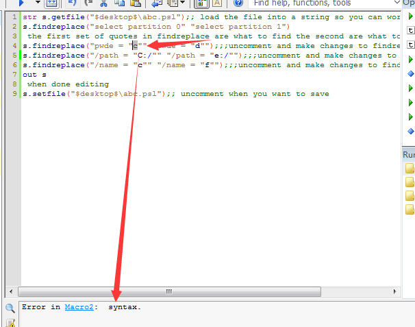

Double quotes will cause errors
str s.getfile("$desktop$\abc.psl");; load the file into a string so you can work with it
s.findreplace("select partition 0" "select partition 1")
;the first set of quotes in findreplace are what to find the second are what to replace with
s.findreplace("pwde = "c"" "pwde = "d"");;;uncomment and make changes to findreplace
s.findreplace("/path = "C:/"" "/path = "e:/"");;;uncomment and make changes to findreplace
s.findreplace("/name = "c"" "/name = "f"");;;uncomment and make changes to findreplace
;when done editing
s.setfile("$desktop$\abc.psl");; uncomment when you want to save
use single quotes inside of double quotes to represent double quotes then code will work
s.findreplace("pwde = ''c''" "pwde = ''d''");;
