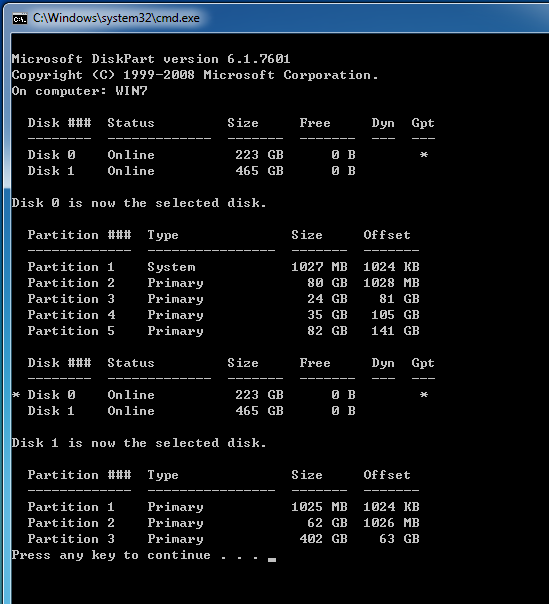

My idea: get the information in the command line, output it to QM, and then retrieve the fields of the hard disk and the fields of the partition.   Exclamation

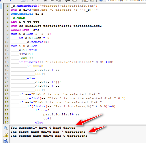

Judge error
The listpart command can be used only after selecting the hard disk.

list part
exit
I feel that this little program needs a lot of perfection.
Sometimes I feel that I haven’t done it manually yet.   Big Grin
i know very well how the cmd code works no explanation needed
was a typo removed wrong line

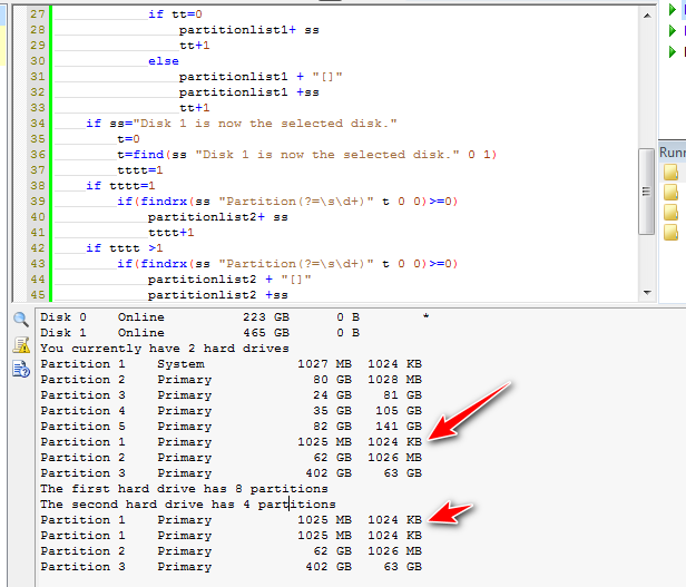

all the information you need is stored in the Array

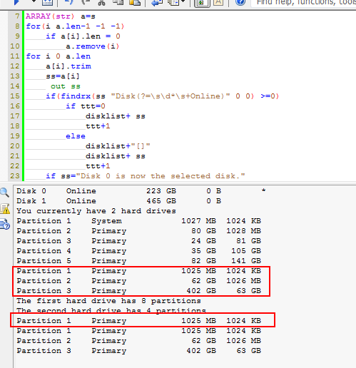

Still partition recognition error

i uncommented some outs so we can see what its showing. sorry had to edit code it didn't paste it all
Repeated calculation
hd0  has 5 part
hd1 has 3 part
that is very odd didn't do that on my two computers
This is the result of cmd processing

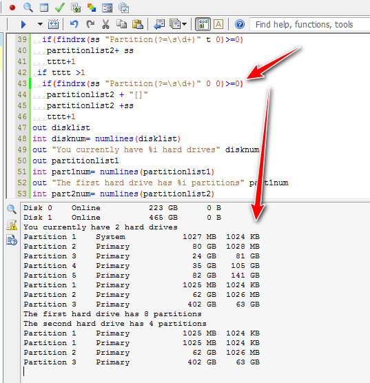

Still wrong,
i'm only on a pc now that has 1 hd but try changing this
change line 43 to this
if(findrx(ss "Partition(?=\s\d+)" 0 0)>=0)
that should fix the second partition list mistake hopefully lol
Still wrong

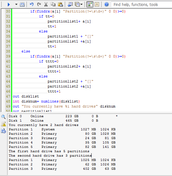

ok hopefully this works for ya

for(i a.len-1 -1 -1)
,if a[i].len = 0
,,a.remove(i)
,a[i].trim
,ss=a[i]
,;out i
,;out ss
,if(findrx(a[i] "Disk(?=\s\d*\s+Online)" 0 0) >=0)
,,if ttt=0
,,,disklist+ a[i]
,,,ttt+1
,,,disklist+"[]"
,,,disklist+ a[i]
,,,ttt+1
,if(a[i]="Disk 0 is now the selected disk." )
,,tset=!tset
,if(a[i]="Disk 1 is now the selected disk."    )
,,tset=!tset
,if tset
,,if(findrx(a[i] "Partition(?=\s\d+)" 0 0)>=0)
,,,if tt=0
,,,,partitionlist1+ a[i]
,,,,tt+1
,,,else
,,,,partitionlist1 + "[]"
,,,,partitionlist1 +a[i]
,,,,tt+1
,,,if tttt=0
,,,,partitionlist2+ a[i]
,,,,tttt+1
,,,else
,,,,partitionlist2 + "[]"
,,,,partitionlist2 +a[i]
,,,,tttt+1
out disklist
int disknum= numlines(disklist)
out "You currently have %i hard drives" disknum
out partitionlist1
int part1num= numlines(partitionlist1)
out "The first hard drive has %i partitions" part1num
int part2num= numlines(partitionlist2)
out "The second hard drive has %i partitions" part2num
out partitionlist2
Great, OK   Heart
Text control can only display one line  Huh
2.for example, if I select disk 1  partition  1, and press the Enter
3. Finally, copy the test.txt file on the desktop to the partition 2 3 4 5
_s.expandpath("$desktop$\diskpartinfo.txt")
str s cl=F"cmd.exe /C diskpart /s ''{_s}''"
RunConsole2 cl s
s.trim
;out s
int i t tt ttt tttt tset
str ss disklist partitionlist1 partitionlist2
ARRAY(str) a=s
,if a[i].len = 0
,,a.remove(i)
,a[i].trim
,ss=a[i]
,;out i
,;out ss

;out disklist
str s1=
F
;You currently have {disknum} hard drives
;The first hard drive has {part1num} partitions
;The second hard drive has {part2num} partitions
mes s1

The above code, under the Chinese operating system, can not get any information  Huh
Chinese command line information in the following file
.zip   china cmd info.zip (Size: 540 bytes / Downloads: 592)
All codes are written  in and for English.  Qm is made to work in english. Install  En-us language pack if you dont have . I can not read or speak chinese, sorry cant help.
this will work for the text file(china cmd info.txt) at least on my pc it does.
