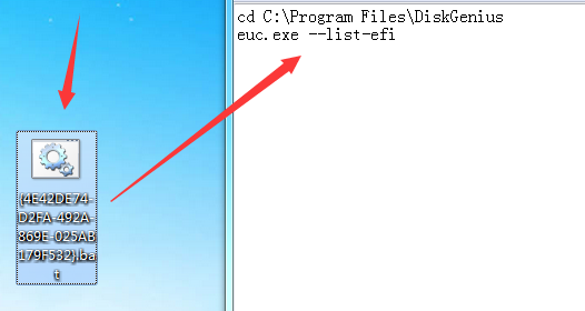

I have encountered an incomprehensible problem
1.Direct run can be successful,
2.But run the command line is failure, Prompt not found file (I need the command line to run multiple lines of commands)

I found a strange problem, under normal windows
cd C:\Program Files\DiskGenius
can run successfully, but under the winpe system, it will prompt "the system can not find the specified path", I do not know how to solve this problem
_______________________________________________________
If I change C:\Program Files\DiskGenius to C:\DiskGenius , it can run successfully. QM cannot be correctly positioned (Program Files)in winPE system

Still failed, I can't take screenshots under winpe, the wrong prompt is "The system can't find the specified path"
This problem, only problems under winpe, under normal windows system, there will be no problem
If I put DiskGenius in the root directory of the C drive, it will run successfully.This problem is very similar(QM can not locate the system32 folder)

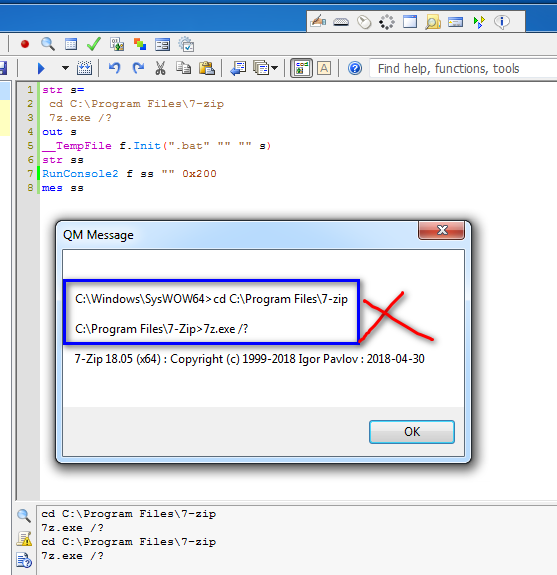

Is there any way to display only the run results , without displaying the command?
Macro1
Trigger
SF9
str s=
;cd C:\Program Files\7-zip
;7z.exe /?
__TempFile f.Init ( ".bat" "" "" s)
str ss
RunConsole2 f ss "" 0x200
mes ss
Posts: 12,272
str s=
;@echo off
;7z.exe /?
