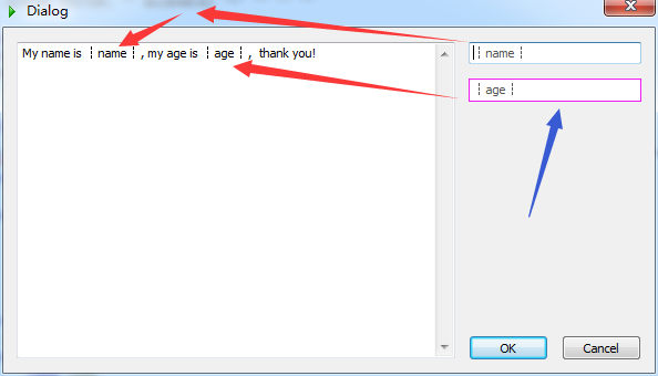

Hi,
In the following dialog box, I want to achieve the effect of replacing text in real time
Please look at the image below, when I enter text in the edit box on the right, the content in the edit box on the left is also replaced, in real time
Also how to change the color of the border line of the edit box, such as the blue blue-headed arrow below
Thanks in advance for any advice and help
david
;0 "" 0x90C80AC8 0x0 0 0 392 192 "Dialog" "4"
;4 Edit 0x54030080 0x200 280 8 104 12 ""
;5 Edit 0x54030080 0x204 280 28 104 13 ""
;3 Edit 0x54231044 0x200 8 8 264 176 ""
;1 Button 0x54030001 0x4 280 171 48 14 "OK"
;2 Button 0x54030000 0x4 336 171 48 14 "Cancel"
;DIALOG EDITOR: "" 0x2040C02 "*" "" "" ""
str controls = "4 5 3"
str e4 e5 e3
e3=
;My name is ┆name┆, my age is ┆age┆, thank you!
,SendMessage id(4 hDlg) EM_SETCUEBANNER TRUE @"┆name┆"
,SendMessage id(5 hDlg) EM_SETCUEBANNER TRUE @"┆age┆"

from the picture it looks as if you want to leave the ┆ in place
if so use this

My description is not detailed enough,The second code above is closer to my idea
I want to replace the two fields (┆name┆ and ┆age┆) If they exist, in the E3 edit box in real time, The E3 edit box content inside is constantly changing, Not fixed
