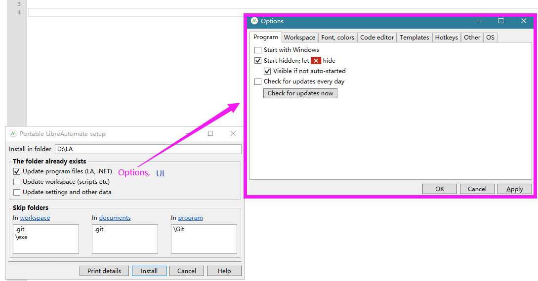

https://i.ibb.co/56LjGRv/B.png
It seems that the settings for LA are not separated or independent.
I am confused about the output information. Some settings are not synchronized with the portable LA version, so I have to manually operate them.
Posts: 12,205
The "Moving old data folder" can be confusing. Actually the old data remains. Just moves temporarily to a temp folder and then back, because the data folder is in the program files folder which is replaced.
Posts: 1,152
Threads: 267
Joined: Jul 2022
Thank you for your explanation.
The UI layout settings and option settings of the LA have not been copied over in synchronization.
Posts: 12,205
It is part of data, not program files. Do you want to copy settings but not workspace files?

I think the updates to options and UI layout should also be included in the first item, as shown in the following diagram.
https://ibb.co/5LbbynF
If placed in the third item, we need to consider excluding certain files.
Posts: 12,205
ibb.co often is slow or I can't access it. Today can't access.
